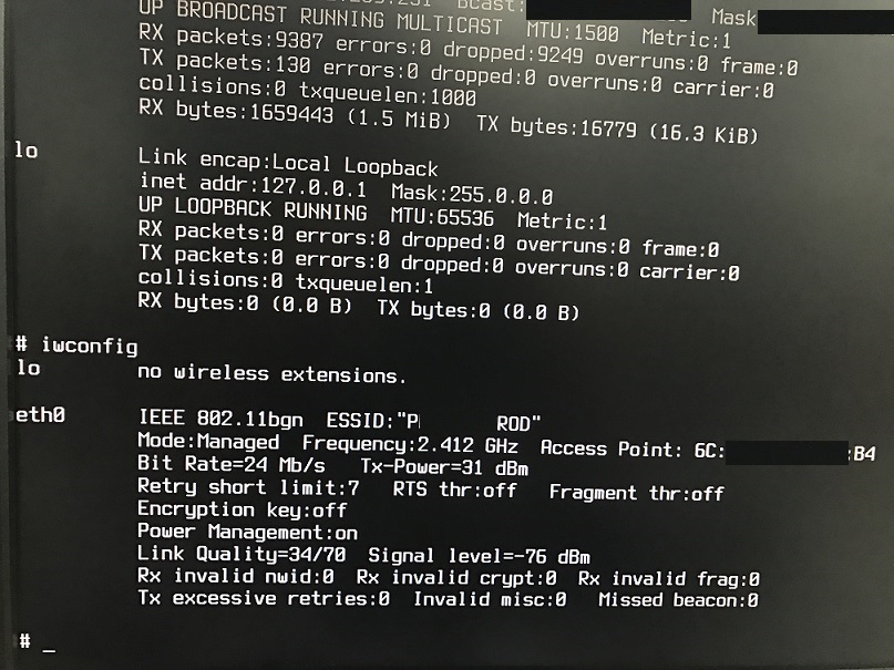

Hi Aka,
Please refer to attach photos.

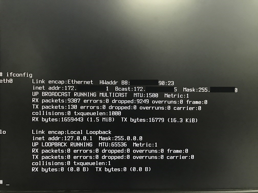

1. ifconfig.jpg - The Static IP Address was define here
2. iwconfig.jpg - No IP address is being observer
3.ping.jpg - Ping did not went through the gateway
Will continue with log on next post as maximum only 3 phot allow.
Thanks,
Ken

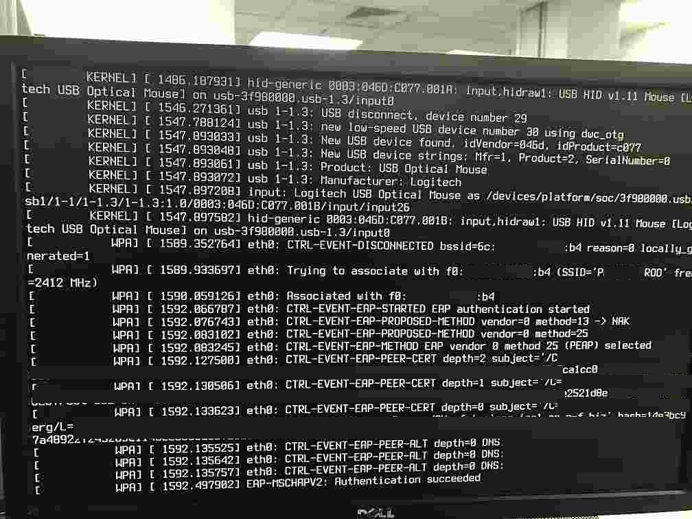

vincny
Posts: 35
Joined: Tue Nov 01, 2016 9:58 am
Re: Wireless WPA2 Enterprise Authentication
Post by vincny »
Hi Aka,

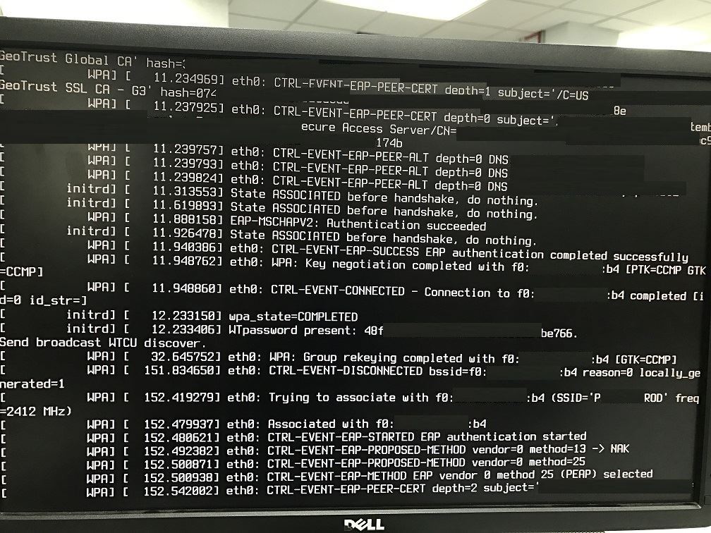

4. all_log1.jpg - Authentication successful has been observer
5. all_log2.jpg - No relevant Wireless log
6. all_log3.jpg - No relevant wireless log
Thanks,
Ken

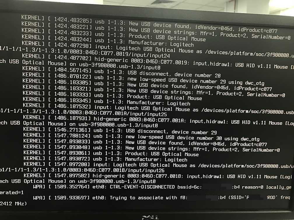

ifconfig and iwconfig look right. And there is some traffic received/transmitted.
Why are there 1500 seconds since boot? Did you take the photos immediately after boot, without entering setup?
4. all_log1.jpg - CTRL-EVENT-DISCONNECTED, and it knows AP mac. Seems it is not the first connection after reboot. Please, make me photos after boot.
2. iwconfig.jpg - No IP address is being observed - iwconfig should not display IP. It's WiFi configuration.
3.ping.jpg - Ping did not went through the gateway. - Please, ping something LOCAL. In WiFi subnet.

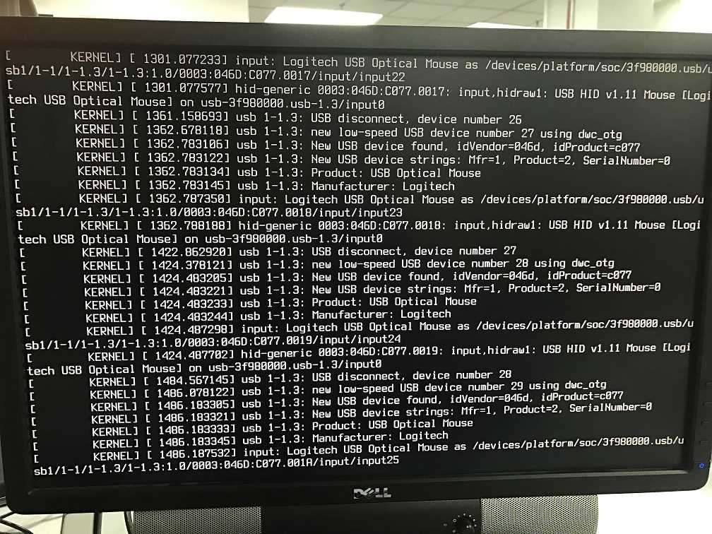

And please disconnect USB mouse Logitech. It disconnects every minute and sends a lot of text to log.

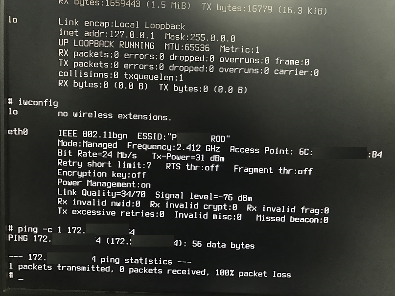

Hi Aka,
I am sorry for the delay, please refer to the new photo taken.
1. Ping.jpg - I have tried to ping IP address on the same subnet but same result.
2. All_log1.jpg, All_log2.jpg - Hope you can help to find something here.
Thanks,
Ken

vincny
Posts: 35
Post by vincny »
Hi Aka,
Continue with all_log3.jpg, all_log4.jpg - Hope it is useful for you to help to make it work.
Thanks,
Ken
Everything is right, as far as I know.
Does Raspbian work with your WiFi?
Send me dmesg, ifconfig, iwconfig output:
dmesg > /tmp/123.log
ifconfig > /tmp/234.log
iwconfig > /tmp/345.log
and wpa_supplicant.conf, if it exists
