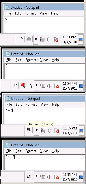

Re: Keyboard ja layout
Please, install and boot this:
http://pxe.ru/files/testing/201011051150.zip
This build will post scancodes we receive from hardware. You'll see new lines in wtware event viewer every time you press or release any key. Please, put log samples here for every incorrect key and write, which char should appear in notepad. Chars appear incorrectly when you type in ENglish or in JApanese?

Thank you for providing debug program.
In English, which ja imput-method is turned off (= single-byte mode).
Okay. Every key described below is laid out as:
http://ascii-table.com/keyboard.php/194
key 'Size' (shown on left-top corner in http://ascii-table.com/keyboard.php/194)
expected: ja imput-method toggled and no char should appear
incorrect result: '`' (backquote) appears on notepad
It seems I do not understand, what is "layout".
I have keyboard with 'shift' and with '6'. I have mstsc.exe and original english windows7. I add Japan language, keyboard Japanese and Microsoft IME. In "JA" language, with both keyboards I got ^ when I press Shift-6.
In "RU" language, I got :
In "EN", I got ^, same as in "JA"
What should I do to get & when I press 'Shift-6'?
- Untitled.png (16.43 KiB) Viewed 49644 times
Probably you need to change keyboard driver at the Device Manager to emulate JA layout. Please see attached image.
Successful with local windows.
Unsuccessful with mstsc.exe.
Now I have two windows (winXP sp3 and win7, both english). Both have 106-key keyboard driver installed and three languages (EN, RU, JP). When I select JP, I got & for Shift-6 in both OSes. Locally.
But when I connect with mstsc.exe from one windows to another, I got ^ for Shift-6 in EN and JP.
Where am I wrong?
Where am I wrong?
Please set the Input Language in the Text Service along with attached image.
Yes!
Thank you.
Now I need some days to do the same in WTware.
Thank you.
