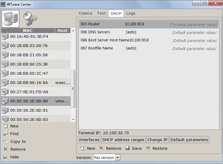

Other what I don't understand. When I try to restart the terminal from the right click popup menu, I get a message "Failed to determine terminal IP, perhaps terminal is not working in network now."
But when I check the log of the terminal, I see it gets IP from DHCP so the WTware Center should know the client's IP.

Are you using WTDHCP server?
On this tab:
do you see terminal IP?
If not, set it manually, as you know it.
Please show me terminal log after you pressed Restart button.
