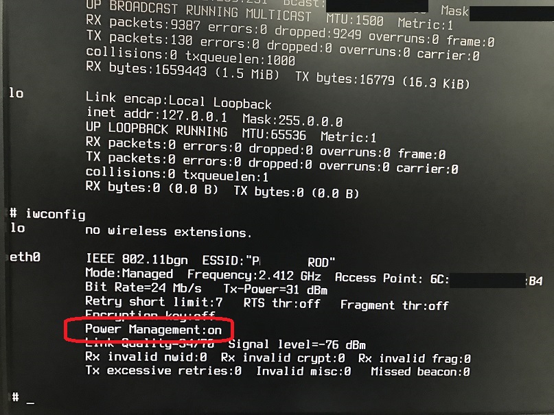

Hi Aka,
Thanks again, the wireless authentication is now working, but I hit another issue that it will turn off by itself when the rpi session is idling
I have do some read out and this could the potential cause:
http://raspberrypi.stackexchange.com/qu ... nt-setting
1. Upgrade the wireless firmware
sudo BRANCH=next rpi-update
2. Turn off power management.
sudo iwconfig wlan0 power off
Can this be integrate to WTware?
Again your help is very much appreciated.
Additional link info:
It also mention on the be link that it will improve the wireless self turn off and performance issue.
https://www.raspberrypi.org/forums/view ... 7&p=924657
Thanks,
Ken
Turning off wireless power management
- iwconfig.jpg (200.25 KiB) Viewed 12481 times
Re: Turning off wireless power management
Please try: http://pxe.ru/files/testing/201611181321.zip
You can see iwconfig output on embedded web server.
Hi Aka,
I was wrong, I still get disconnected after the power management was turn off.
Thanks,
Ken
Thanks,
Ken
Signal level is low. Try USB WiFi with external antenna.
Hi Aka,
Just want to keep you updated.
1. Turning off wireless power management does help to improve rpi 3 wireless connection please keep the setting.
2. After further checking I realize that the connection drop off due to timeout session configure from wireless lan controller.
3. I have further fine tune the wpa_supplication and the wireless connection seem to be more stable now.
Ok. It will be in 5.4.62 and the following versions.vincny wrote:1. Turn off wireless power management does improve rpi 3wireless connection, please keep the setting.
