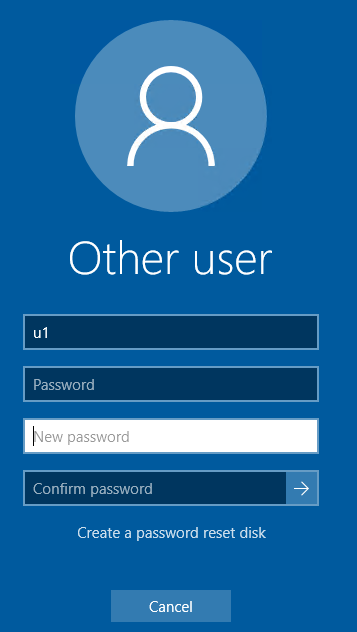

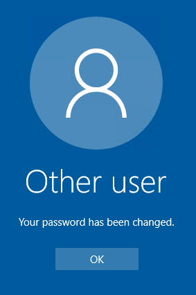

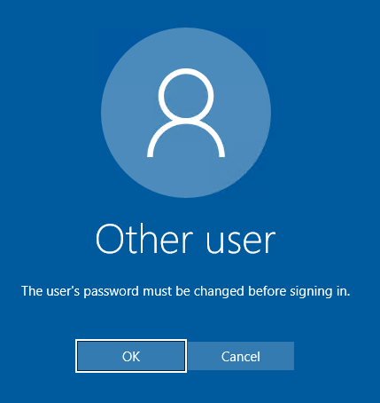

Why password change not functional in 2) ? Here is my 2016 without NLA after ask_password=on:
I press OK, and:
I press OK, and:

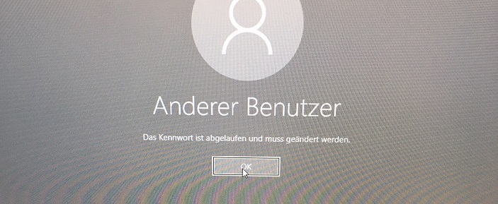

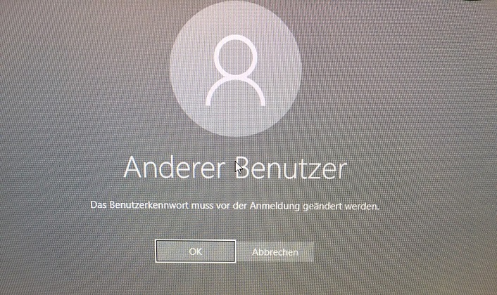

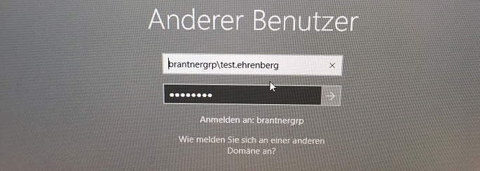

ok, think there is a strange behaviour - tried it on our 2016 test rds server without a broker.
after login, the user receives the message to change password -> hit ok -> and then the loginscreen in attachment2 appears - but its not possible to login
maybe its a CredSSP thing - going to try a few things
