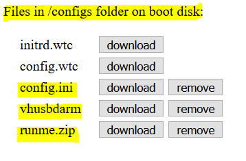

I found a solution on how to enable the license of VirtualHere permanently on WTWARE, even with the "specialized" VHUSBDARMPI4 version and not the generic VHUSBDARM. I use this on several WTWARE RPis which boot from sd card.
1.) Prepare a sd card with Raspian OS LITE (don't forget to enable SSH access) for your desired WTWARE Raspberry and start it up
2.) SSH to your Raspberry and download the appropiate version of VirtualHere (for example: wget https://www.virtualhere.com/sites/defau ... usbdarmpi4)
3.) Within the folder where you downloaded the file run the following commands:
chmod +x vhusbdarmpi4
sudo ./vhusbdarmpi4 -b
4.) Start the VirtualHere client on a Linux/Windows/OSX machine and you should see your Raspberry "server". It will state that it's unlicensed once it's discovered. Right click it within the client and select "Properties". At the right side of the license field you can click buy to obtain a license. Once you received that you can enter it within the client. If you plan to rename the USB server you can do this here too. Otherwise it will use the upcoming WTWARE hostname (PI-*MAC for example).
5.) After you entered your license establish a SSH connection and cd into the directory where you downloaded and started the vhusbdarmpi4 file. Run this command:
cat config.ini
It should look like this:
It=123456789
EasyFindId=Abcdefghijkl
EasyFindPin=a1b2c3
License=<LICENSE NUMBER>
ServerName=<HOSTNAME>
6.) Mark/copy everything from this INI file and paste it in an editor. Save this file on your workstation also as "config.ini"
7.) Download the same version of VirtualHere to your workstation you used in 2. Rename it from "vhusbdarmpi4" to "vhusbdarm". Create the "runme" file without any extension and paste the following in it:
#!/bin/sh
chmod +x vhusbdarm
/vhusbdarm -b
8.) Save the file and create a ZIP which contains:
- runme
- vhusbdarm
- config.ini
9.) Start a https browser session to your WTWARE RPi and add the appropiate entries to your config (as described in the official howto):
extra=name_of_your.zip
vhusb=on
10.) Upload the your ZIP file AND the vhusbdarm & config.ini (see sample screenshot attached)
11.) Reboot your WTWARE RPi and the USB server should be detected as licensed
