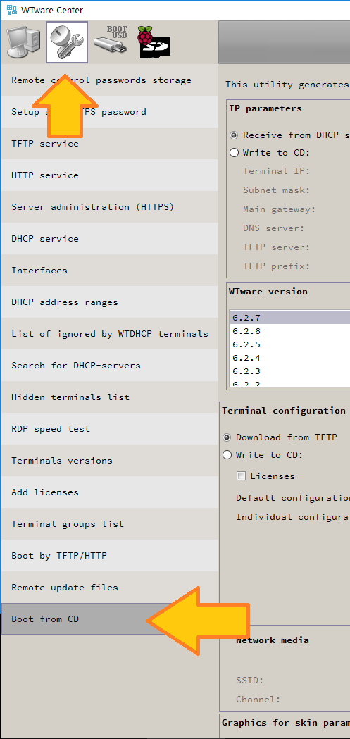

Boot CD should boot if made as Boot CD. Not Boot USB.
Here:
Here:
- Untitled.png (44.06 KiB) Viewed 85676 times
rick
