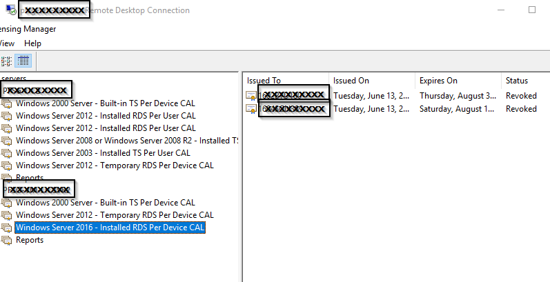

If we run a windows 7 or windows 10 machine and do a remote desktop tot he same server the client device license is registered to the license server. Example in Picture 0.

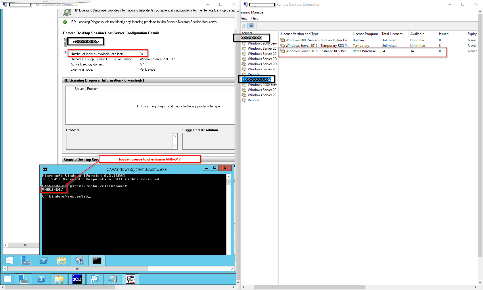

Picture 1 shown that the Windows 2012 R2 is able to detect the 2016 Remote Desktop Licensing Server with available licenses but not issue the license to the Raspberry client.
Attached WTware.txt is the log file when the WTware Raspberry connected to Windows 2012 R2 RDSH.

Thank you for responding, below is the detail on the setup.
We are running on Windows 2012 R2 Remote Desktop Service Host (RDSH), with 2016 Remote Desktop Licensing Server.
