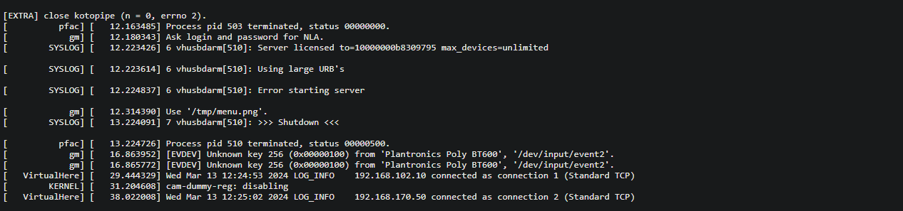

Here is the Wtware Log screenshot:

i have tried the following things.
To point 2:
Using the binary names vhusbdarmpi4 and vhusbdarm with renaming and change in runme, but that didnt work. I upload the three files runme,config.ini and the zip file locally on the wtware disk.
And i have updated the Version from 6.2.12 to 6.2.16 and tried the same. But that also didnt work.
To Point 3:
The RDS-Server connects to it, because the Virtual Client is installed as Service to handle multiple Virtualhere Connections simultaneously. But when i paste the license on the VH Client then it will be accepted, but when i reboot the Pi the license disappear and will not save persistent.

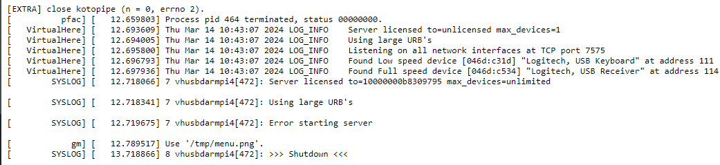

3) And what means Using large URBs? After that the error happens
The screenshot:
Kind regards,
Keanu
Re: WTWare Virtualhere USB Server shutdown after licensing
Please. Show. Me. The. Logs.
Full logs.
On every case that didn't work.
Send to support@wtware.com if it includes any sensitive data and cannot be published.
