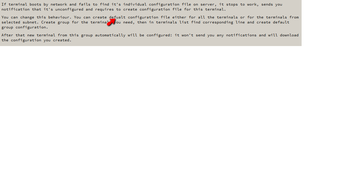

We've just released a new version, that will help you to have default configurations for terminals groups.

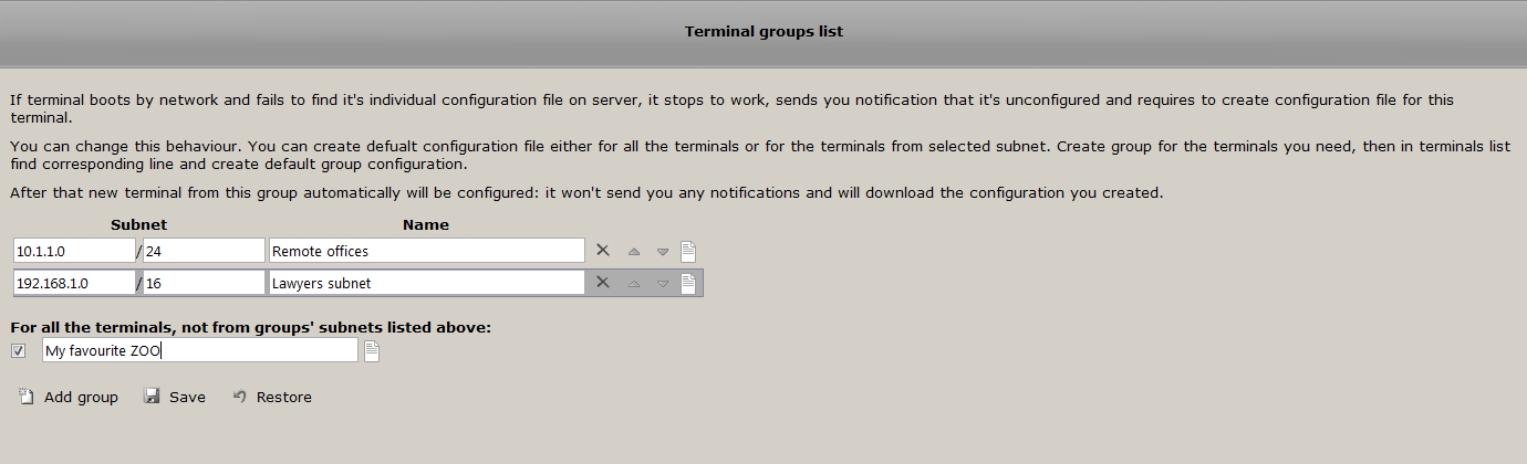

Group is specified by subnet IP and mask. You create config from this group, i.e. for terminals from this subnet, and when new terminal boots and there's no configuration for it on server, then TFTP will download config for this group, default individual configuration file for all the new unconfigured terminals in selected subnet.
In directory "Everyone" now you can find file "default.wtc". It's the file to specify needed groups by subnet. Please, read comments there.
Also there's new interface in Configurator Utilities - list of groups.
Here you add new group:

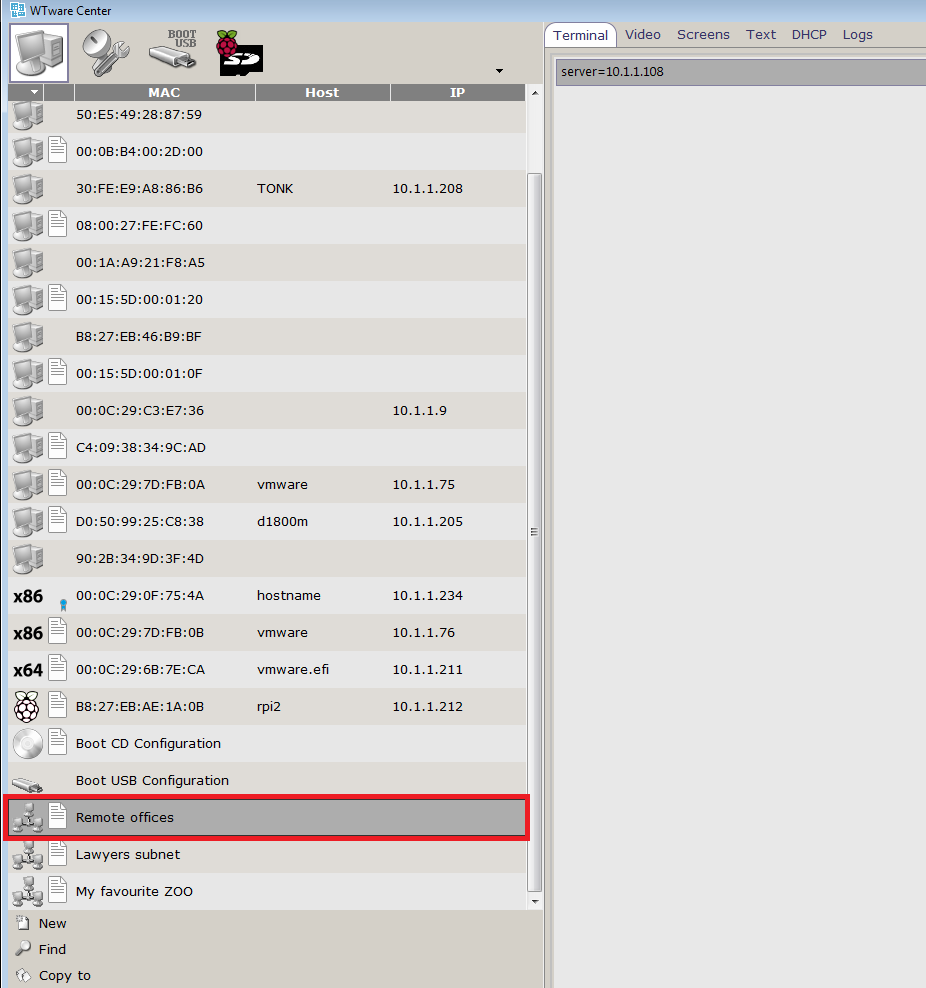

And here you create config for it:
Also there's group "All". You may create config for all terminals, that are not from subnets for specified groups.
