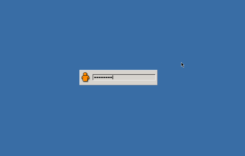

I'm also having issues getting the custom background to display on the login screen (I don't have a server selection screen)
I have created a menu.png file (1024 x768 8bit colour depth) and copied it to a separate folder within the Graphic directory. i.e. Graphic\sample
I then edited the config file to include the line i.e. skin=sample
However when I boot up the Pi I just see a blue screen and login prompt but no logo.
Any suggestions?

Do you want to see your image on this screen?

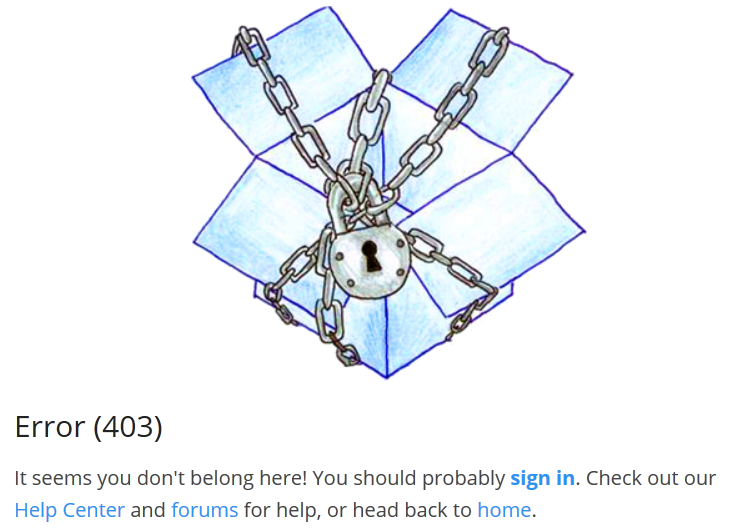

P.S. Here is what Dropbox shows me when I try to open your image:

Thanks for the reply. Yes I want to put a custom background on that screen to show the company logo if possible.
Re: menu.gif and keyboard issues
Ok, will be in the next version.
