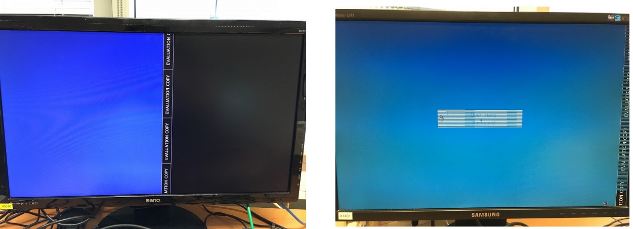

Only one problem remains as you can see in the picture I've attached you. Left side shows the monitor which should be in portrait mode, but some parts of the picture are cut off. Right side shows the other monitor with some shuttered lines. This behaviour only occures if I add the portrait parameter to the config file --> see log1.txt
If I test the config with the video=intel(U) parameter, the screen stays black with the underscore in top left corner --> see log2.txt
best regards

Re: Rotate Screen
Do not write "video=i915(f)". Write:
video=intel(u)
Do not write "display=...DP" and "m2_display=..DP2". Write:
display=1680x1050, HDMI
M2_display=1920x1080, HDMI2
And remove all unnecessary lines from config. "sound=" and "microphone=" in logs are completely wrong.
