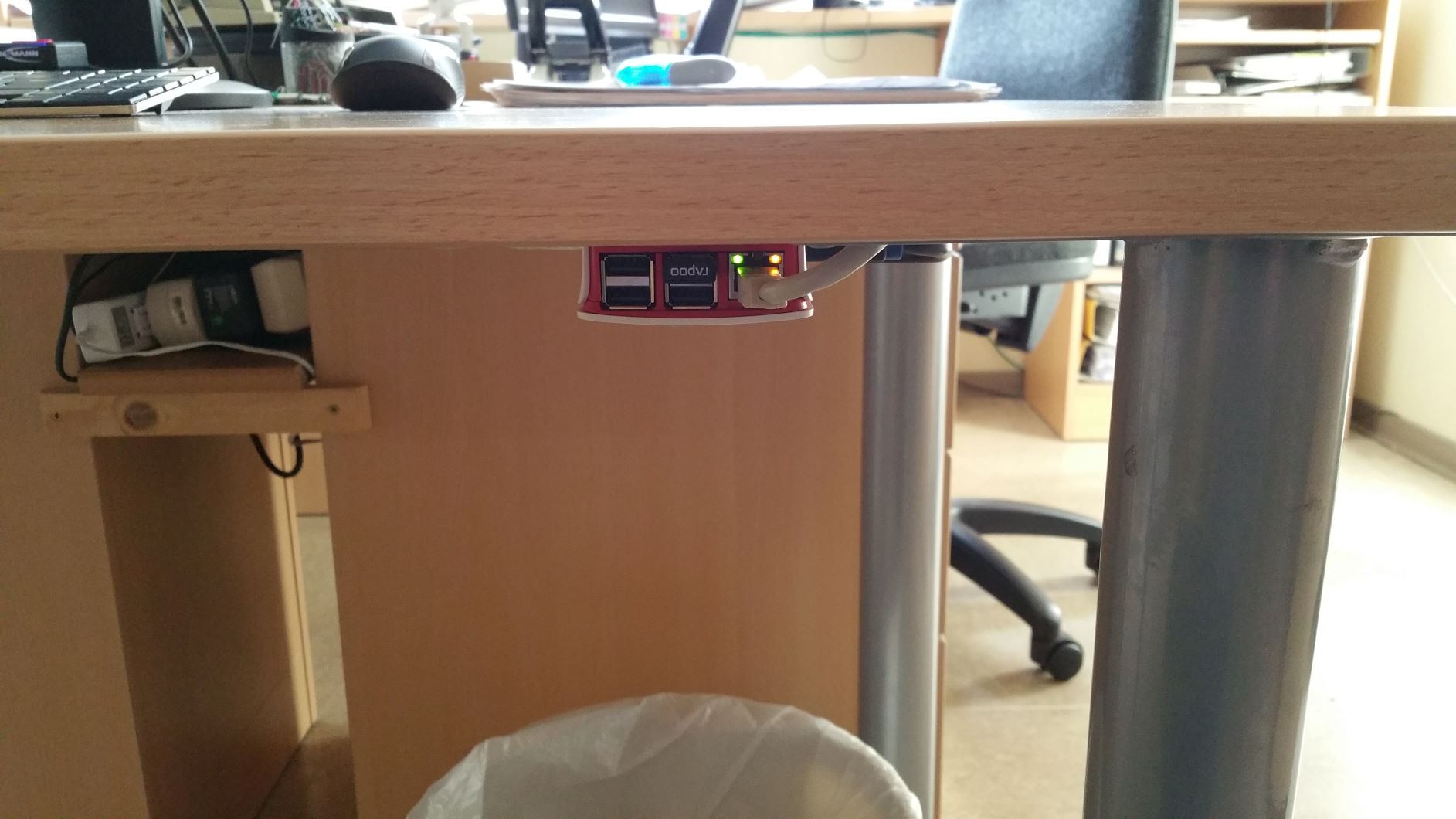

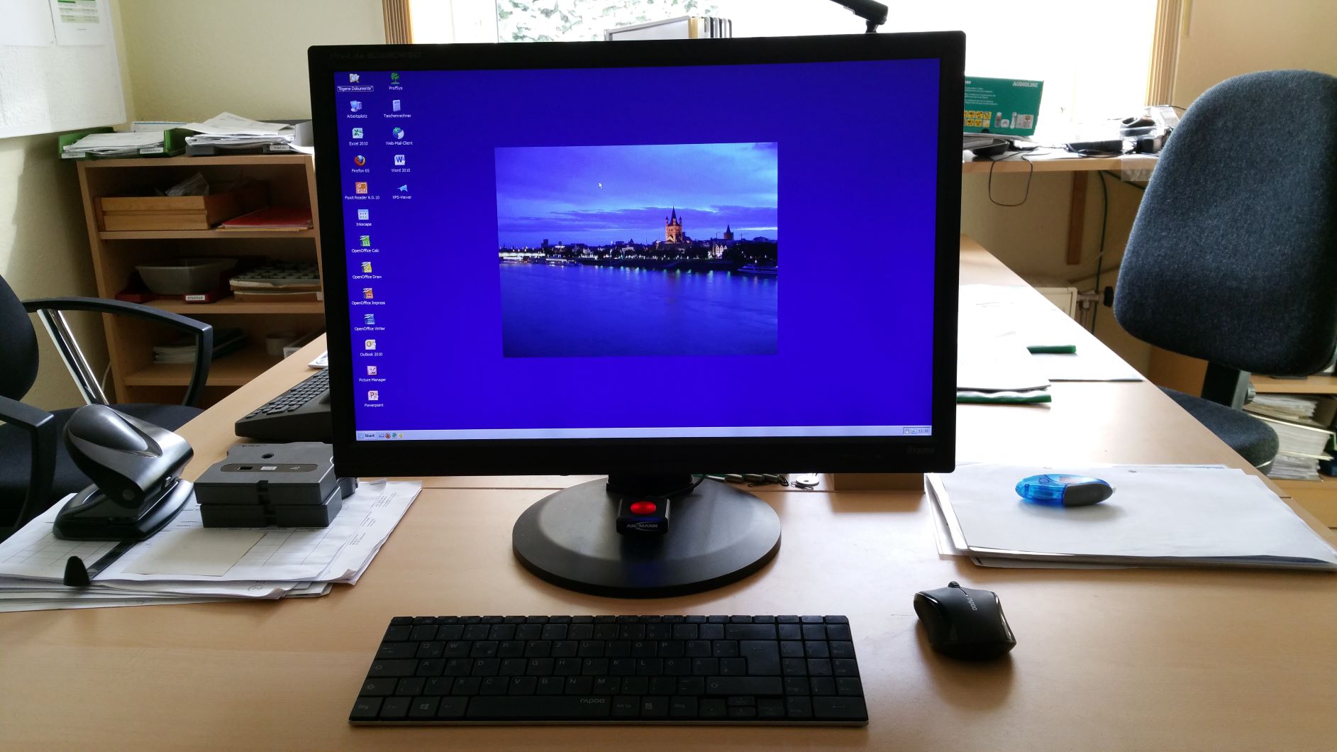

I already have 15 Raspberry Pi 3Bs with WTware as terminal server client in use.
This works great.

Attached are 2 photos of such a computer workstation.

Only the monitor is on the desk and the power button is fixed on its base.
The monitor and the Raspberry are connected to the AES3.
After logging out of the terminal server, the monitor switches to standby mode. When the standby current of the monitor is reached, both devices are automatically completely disconnected from the socket after one minute. Then the devices do not consume any standby power.
