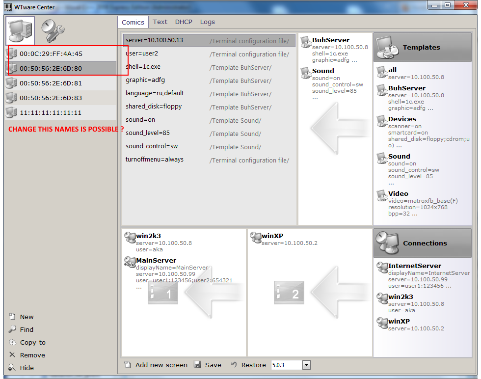

3-It is possible to change the name of certain machine in WTWarecenter ? (mac address is not to friendly if you have this deployed along the country with VPN)

careonecomm wrote: Tue Apr 28, 2020 8:25 pm 3-It is possible to change the name of certain machine in WTWarecenter ? (mac address is not to friendly if you have this deployed along the country with VPN)
1. "Comment" field on DHCP tab in WTware center.
2. "Host" field on DHCP tab in WTware center if WTware DHCP is used. Or in 012 option of your DHCP. Or clienthostname= option in terminal config: https://wtware.com/docs5/config.html#clienthostname
3. Button with three horizontal lines to the left of the Raspberry SD button on your screenshot.
