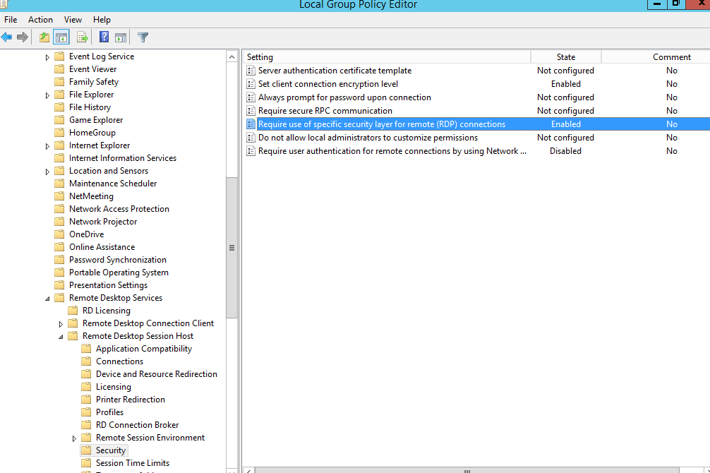

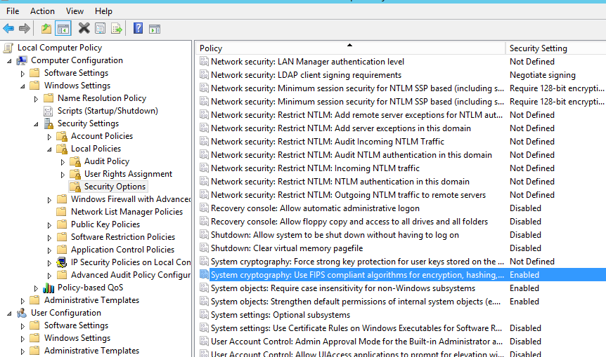

I found the source of this error. You turn on FIPS encryption. FIPS is paranoid mode for old-style native RDP encryption. WTware didn't support it before and there is no reason to support it now, when RDP can work over SSL/TLS.
Find and turn FIPS off. It is default setting for all Windows Servers. Here should be DISABLED:
And there should be no "FIPS" anywhere:
Turn On SSL/TLS in "Require use of specific security layer" to disable old-style RDP encryption.
