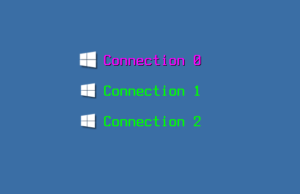

Please try this:
http://wtware.com/testing/202002220938.zip
In config:
menu_colors=00ff00,ff0000

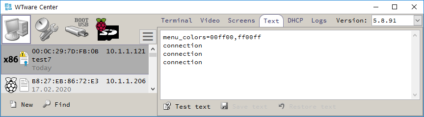

Re: Change the font color?
Sorry, I didn't test configurator :(
Write value in "Text" tab. It will display errors, but save config.
