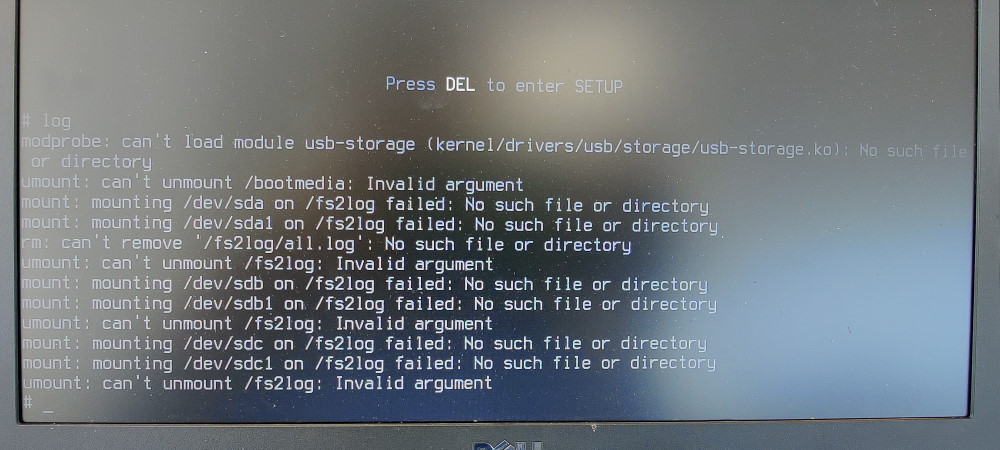

Re: UEFI Error: Failed to mount boot media
https://wtware.com/logs.html
Take USB flash, common, small capacity, without passwords, without encryption.
Format it. File system must be only fat32, others won't work.
Connect newly fat32 formatted flash to terminal.
From terminal command line run command:
log
Wait for half a minute. On the screen you may see errors, it's ok. Make photo of the screen and attach photo to e-mail.
Eject USB flash. Connect to windows computer. On this flash should be file all.log.
laesyar
Posts: 27
Joined: Mon Aug 17, 2020 4:32 pm
Post by laesyar »
Unfortunately that also doesn't work
